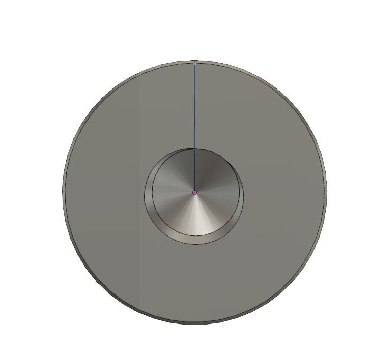

Here is a link to part.  We are having trouble with Setup2.  Already shorted program to bare minimum processes .

Line 54 - G83 X0.0089 C-72.938 Z-.06 R0.2 A0.0797 F0.004 (G83 is not a usuable code for Haas lathe,, shouldn't X be X0.0?
Line 74 - Not sure about G95.   It sure appears to look at my program as a mill program specifically.
https://autode.sk/2NR0edP
Message 6 of 11
ArjanDijk
Don't touch the Haas ST posts, they are for machines with driven tools.
In your setup2 your are not drilling in the center. There is a slight offset. This is off course not possible with a 2 axis lathe. Open the sketch and adjust the midpoint. See the code below

Thanks, I reviewed my students model and see where he missed the origin of the hole location.  I used the haas lathe post you recommended and got rid of the Caxis movements and the subprogram calls.  I lost my canned drill cycles and now have tailstock and chip conveyor code showing up.   I no longer have a variable field to turn on/off tailstock or chip conveyor.   I can still have them manually remove those commands, but would be nice to not have to worry about it.
