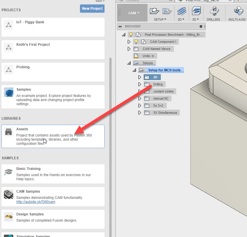

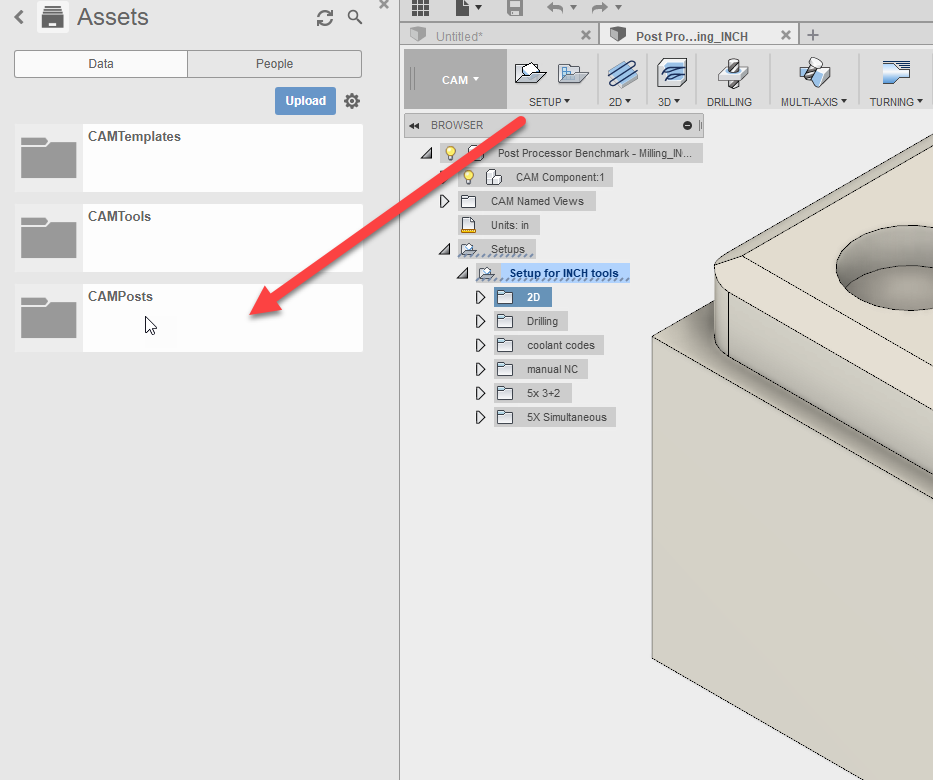

keith_clausen
Hi Andy,
I think I know what the issue may be. You have uploaded the revised post to you Assets/CAMpost folder but can't se how to select the Cloud Post that you uploaded in the post dialog during posting. Is that correct?

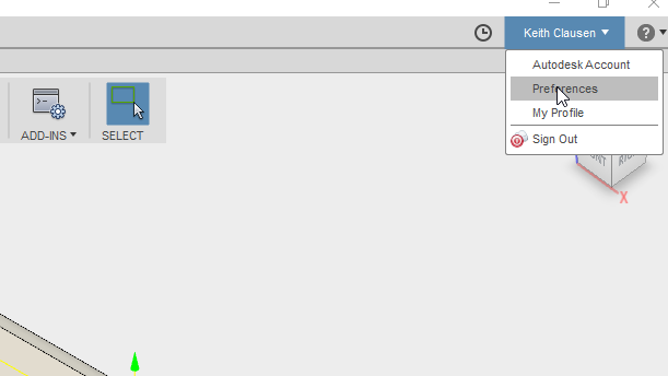

If this is the case, but you are not seeing "Use Cloud Post" as an option to set the path, then you need to enable "Enable Cloud Libraries" found in "Preferences". You may need to restart Fusion once enabled.
