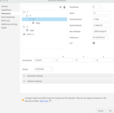

I had the same problem. I changed the orientation for the "B" axis to "-1". See attached image.
To do it within the post processor would look like this.
var bAxis = createAxis({coordinate:1, table:true, axis:[0, -1, 0], preference:0, tcp:useTCP});
Notice I also removed the range. If your range is infinite then the range is not necessary.
Hope this helps!

oh wow i think i got it working on posts!
my machine b axis is turning on x axis, which i put the -1 into the first of the 3 positions
var bAxis = createAxis({coordinate:1, table:true, axis:[-1, 0, 0], preference:0, tcp:useTCP});
also i have set the eulerconvention into true and etc
Hopefully it wont crash anything on machine =D
Thank you and let's see!

Also now after i post the nc, it gave me this warning beside the NC program:  Warning: The provided CAM machine configuration is overwritten by the postprocessor.
is this normal for 4th axis/5th?
i think it maybe my post processor difference between the machine builder and the post

1001_nc
in reply to: davidlam4TGED
If you use the "defineMachine()" function then it will override what you have set in the machine builder.
Just set the "if" statement to false and it will follow your machine builder.
