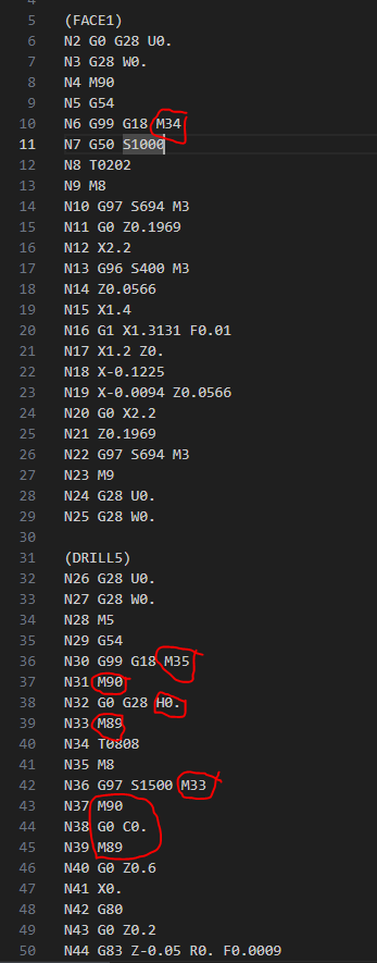

I need help in editing out M33,M34,M35,M89,M90 from the DN Solutions Doosan Mill turn Post Processor in fusion 360. My machine keeps alarming and displays incorrect nc address on the controller. I manually deleted these and my program ran fine without any issue.
On n-value 32 i get an h value call out that needs to be removed. controller runs fine with out it. I am assuming it is used with machines with live tooling.
I also noticed that that on n-value 36 in the picture it has an M33 instead of an M3. I need an M3 to rotate the spindle.
For some reason on n-38 I get a C0. value but i have no live tooling in the lathe so it needs to get removed.
Machine is a 2012 Dossan Puma 240b no live tooling with Fanuc Oi model D controller

You are correct that those codes are meant for a machine with live tooling. We have a Doosan (Now DN Solutions) turning post which is meant for machines without live tooling. Have you tried that post?

Yes, I have tried that and the post is working alot better. An issue I am having now with the new post is if I try drilling the program posts a g81 canned cycle but the controller doesnt recognize a g81 (get an improper gcode alarm). I have a Fanuc Oi-TD controller.
AlanLA6J6L
Figured out that the controller uses g83 for drilling (if you want to run a regular drill cycle just delete "Q" from canned cycle.
