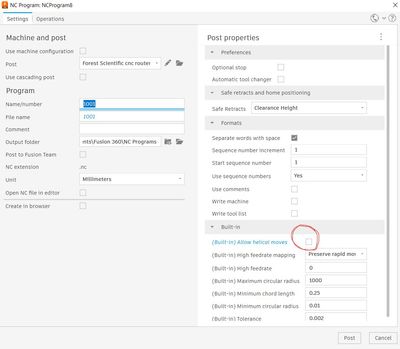

I know this post is several years old, but I ran into the same exact issue today and figured out an easy solution that wasn't provided above. Hopefully this helps folks who run across this issue in the future.
First, make sure you have the Forest Scientific Post Processor downloaded and installed on Fusion. Here's a video to help with that:  https://www.youtube.com/watch?v=eY8e4un-wm0
Next, when running the post processor, make sure to choose the Forest Scientific Router processor. In settings (in the post processor window, also called NC Program) at the bottom right, in the "Built In" menu unclick the box next to (Built-in) allow helical moves. (see attached image). This solved the problem for me. I hope it does for you!
This box should be empty.This box should be empty.
