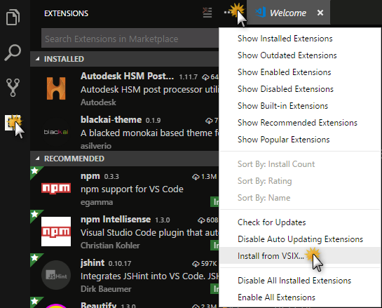

I'll be running some more tests before publishing this version. However, if you would like to test this, I have attached an installer below. To install using the attached file, simply unzip the file and use the option 'Install from VSIX' inside of VSCode here:
This will allow you to specify the VSIX file to install. Once the install is complete, you will need to 'reload' VSCode (F1 > Reload window)
All feedback is greatly appreciated!
