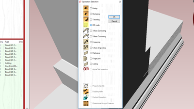

Anyone know how I could output 5 axis code from fusion360 to Pitagora?

I output all operations in the "ISO-code"
cnc: Paolino Bacci (TWIN JET)
Pitagora version: 5.04.25

I myself created a postprocessor for my machine. I usually skip trajectory through a postprocessor. There are two ways to upload the received code to the "Pitagora":
1 simply select the code, copy and paste it into the "iso code" operation.
2 in the operation "iso code" on the left from the bottom there is a section "external file" indicating there the path to the file.

Hi, I used the thermwood 5 axis post from the fusion website, had to modify the gcode after the post using the text editor

Pitagora uses A and  C as the additional axes. The Therm wood post uses B and C axes as the additional. I had to open the text file after the post was completed; find and replace the B with an A before sending the code to pitagora .
