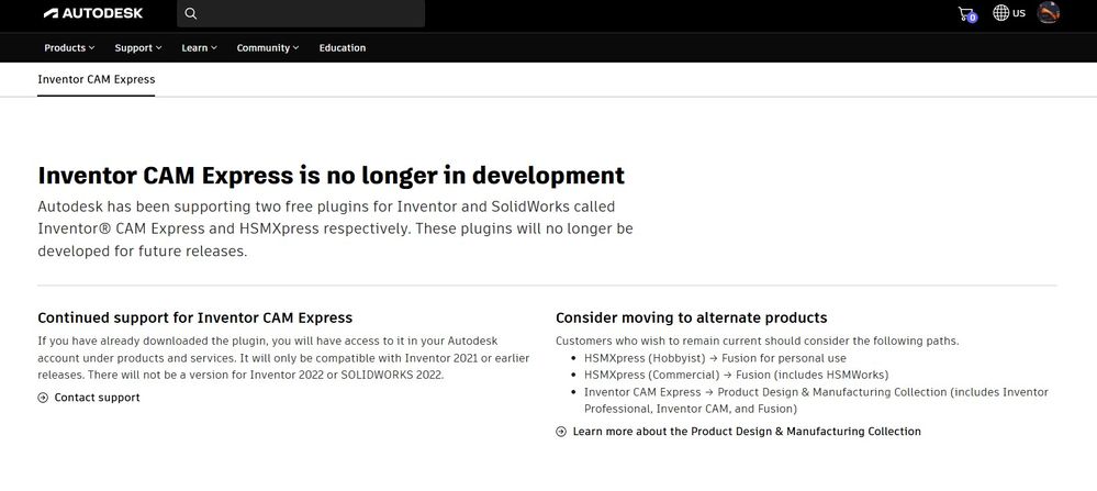

HSMXpress is a dead product not sure you'll get help as it is so old.
