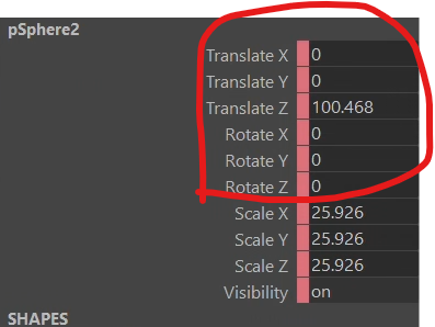

hello,
i set up the character controller to entity on the keying scale animation terrain
like bellow attached .gif file.
character controller doesn't follow exactly the translate terrain by scale.
how can i set up the character controller exactly on the entity on the moving terrain?
Thanks in advance

chlrh1226
i use golaem version 9.0.2 and maya version 2024.
and i want to crawl up  each entity ( with character controller) on the moveing terrain( scale keying or deformed mesh)
but when i did a simple test(attached  gif flle), CC not follow exactly...

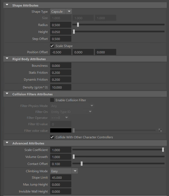

chlrh1226
cc setup
entity setup
Message 6 of 11

Message 7 of 11
chlrh1226
oh, sorry about that. i miss it.
i try with rigid body on sphere, still CC not follow that.
fix physics locator setting value. like that.
but still not follow the entity...
is this normal thing?

chlrh1226
Thank you for your reply.
first, i try to set up the character controller to entity on the keying scale animation terrain.
cc_error01(attached)
but i find out rigid body not follow the sphere mesh (&terrain )
even CC is not follow the entity.
https://forums.autodesk.com/t5/golaem-forum/cc-is-not-work-property/td-p/13660961
now this question is almost same upper question.
and now i got your last answer, i realize rigid body can't support scale keying animation & vertex keying animation.. right?
i thought rigid body support the scale keying animation & vertex keying animation..
because when i click the button "force refresh", it fit the mesh shape.
rigidBody_scale_01(attached)
rigidBody_deform_01(attached)
but you mean rigid body can't not support this both way. right?
rigid body only support translate & rotate keying animation. right?
Thanks, your help

nicolas_chaverou
vertex animation is not supported by rigid body for sure - this is a limitation of the 3rd party engine we're using
I was not sure about scale so did a quick test but indeed it's not supported neither
Position / orientation are though
Studio usually sample / fracture their geometries in smaller pieces and use multiple rigid body in the case of vertex animation / scaling
Does that help ?
