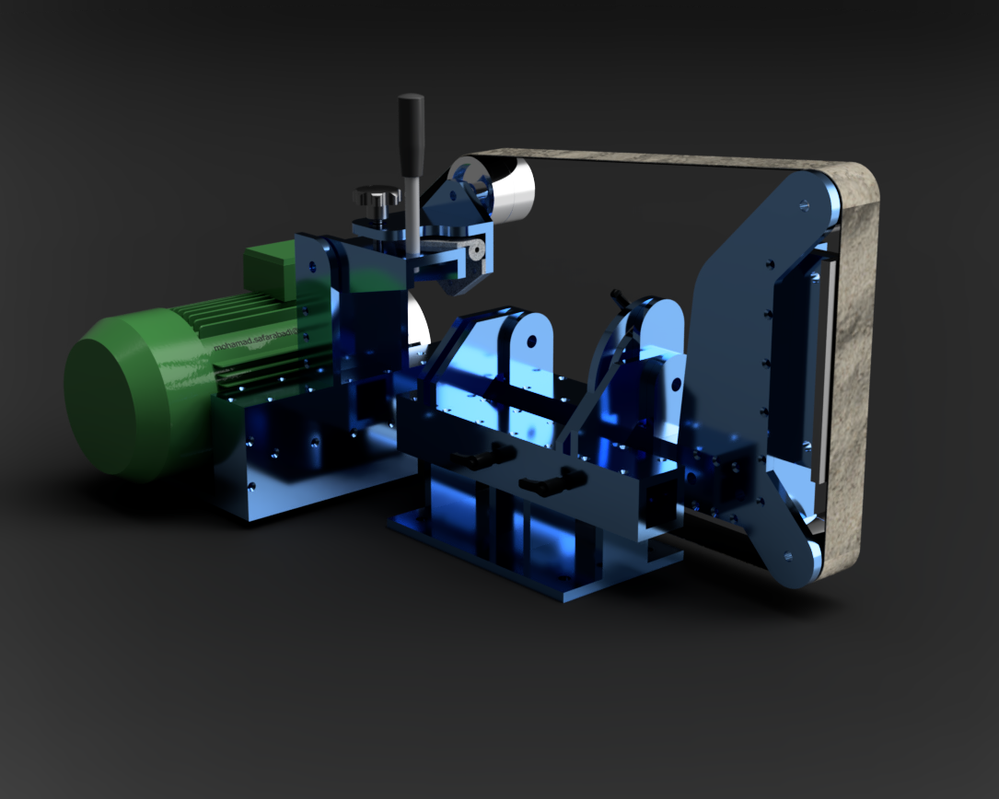

I am working on a belt sander project (pictured in different working versions) that has multiple pieces that can be reused for different variations of the same machine, such as upgrades and interchangeable tool arms.

Fusion.pngBelt_Grinder_Final_2021-Jan-03_04-12-37AM-000_CustomizedView2395476969.pngBandslip1.png
