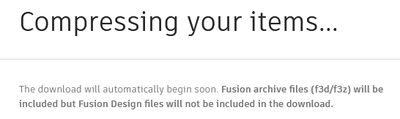

I use Fusion 360 in a university's engineering department, as do all our students.
A research student has recently completed their DPhil.  Before they lose their university Autodesk account I would like them to somehow create a duplicate project in my name and copy all their Fusion 360 files into it.   If that's not possible, then simply transfer the project to my account.    Or at least re-direct it to their private email address instead of the university one, so it doesn't go "Phut" and disappear.
I have tried looking at the web interface and clicking on the Download arrow but it says:
In other words, unless someone goes through every single item and saves it as .f3d or .f3z, it won't get included in the download.  That could take hours!  Surely there is an easier way?

Ron_Young
" That could take hours! Surely there is an easier way?"
Use this.
https://github.com/aconz2/Fusion360Exporter
Video here
https://www.youtube.com/watch?v=QBXYi8_81gc&t=18s
brian.mark
@r.moss The student can change the email address associated with their Autodesk account: https://profile.autodesk.com/security. They will need a licence if they want to continue editing and saving their files. Otherwise, they will be able to access these files to download if they lose access to their school email account.
They can also invite you to their hub so you can download or transfer files to your hub: https://www.autodesk.com/support/technical/article/caas/sfdcarticles/sfdcarticles/How-to-join-a-new-...
