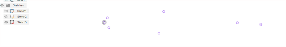

Wing planform complete but aerofoil adding in and solidification problem
The wing planform is perfectly done, so please don't change the geometry on this. Now how do I add the aerofoil cross-sections to the root and tip chords? I've spent hours getting nowhere on this!
This is the aerofoil I am adding to the root and tip chords. But how do I add the airfoils in to the root and tip chords? And how do I close the gap between the last two points of the trailing edge in this aerofoil?
And if you're done, please send me an updated and corrected fusion 360 file of the solution of the solid wing body with the same cross-sectional aerofoils at the root and tip chords.

The Airfoil File needs the Z coordinate for each point. (way too many Points)
Saved as CSV, and the Spline from CSV add-in or script, will draw the airfoil on vertical plane from the Chord line.
For model aircraft there is no such thing as critical airfoil data.
For best Fusion results you only need 4 point spline for top and bottom curves.
However, I still had your original step file, so I modified it -
I pasted your sketch into it.  (you should have it fully defined for accuracy.)
Moved the airfoil plates to the sketch trailing edge/s (presumed no wash out) and Lofted the half wing.
Might help...

The workflow to make your wing with this airfoil is.
Utilities > Scripts and Addins > ImportSplineCSV < Run.
Edit the sketch, join the open gap at trailing edge with a line.
New Sketch - Project the Trailing Edge Line, the Datum point and the other points as needed.
Fit Point Spline command, snap the spline to the top purple points,
Constrain and adjust the handles to have the curve match sketch 2.
Fit Point Spline command, snap the spline to the bottom purple points,
Surface > Patch . select the sketch 3 profile.
Modify > Scale > Uniform, scale the patch body to be 180mm long. (scale factor 18)
Move - Patch body - the datum point to the Leading edge point in sketch 1.
Sweep with Path and Guide Rail - Profile - select the Patch body, Path is Leading Edge line, and Rail is Trailing edge Line.  Set to full Extent, and Scale.
