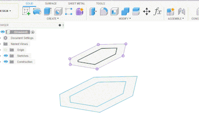

I'm very new to CAD of any type, so I apologize if this is a stupid question.
I'm trying to connect these 2 'ring' shaped faces together, but I'm told that "The loft could not be created" and "Cannot create tool body for loft.".
I tried switching which faces were profiles 1 and 2, adjusting the continuity conditions, and swapping rails/centerline.

In Solid Mode it's not possible to create a loft between rings.
1. Create loft of the outside body
2. Subtract the inside loft from first one

try it this way

This makes sense, thank you!
