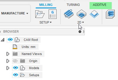

why are 3d printing moves showing up under milling
this happens between face opps and adaptive clearing
adaptive clearing and contours
and even sometimes between contours
also between pockets when programming different pockets.
most of the time they are small moves and do not interfere but other times the want to send the tool outside the machines capabilities.
the orange lines in the picture below is an example.

because all machining operations in the screenshot are milling operations.
If you want to print in 3D, you must create the toolpaths under "Additive".

I DO NOT WANT ADDITIVE MOVES IN MY MILLING PROCESS BUT FUSION IS ADDING THEM IT IS THE ORANGE LINES

seth.madore
in reply to: patVDGEA
This may be a case of "rogue elements" creeping in from another file, I've been seeing a few reports of this. Do they remain after you restart Fusion and open your file again?
Seth Madore
Message 7 of 14
patVDGEA
in reply to: seth.madore
YES

Are you referring to these lines?
Those are not lines from Additive. It appears that there is a bug in the Simulation, those should be displayed and categorized as Rapid/Positioning moves.
We've logged this bug as CAM-43999

the end up in the post cnc program
Message 14 of 14
seth.madore
Yeah, that's where they should be. They are positioning moves from one operation to the next.
If you're running out of Z travel because of them, you can reduce your Clearance Height:
