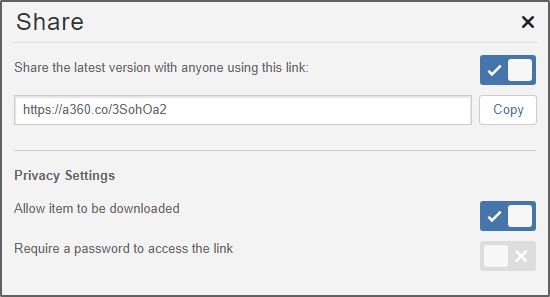

Hello. I'm trying to download the file off CFP trophy v2 - FUSION (autodesk360.com). Maybe I'm just stupid, but I can't seem to find an export button. Does anyone know how to export this file to my device? Thanks!

Whoever shared this file with you, forget to check the "Allow item to be downloaded" icon OR they are using a Personal Fusion 360 License which does not allow the process of Sharing with Download ability.

If you know the Fusion 360 user that Shared the File to you in the first place, then you can send them the instructions below, then they are email it to you.
If you do not know how to attach your Fusion 360 model follow these easy steps. Open the model in Fusion 360, select the File menu, then Export and save as a F3D or F3Z file to your hard drive.
