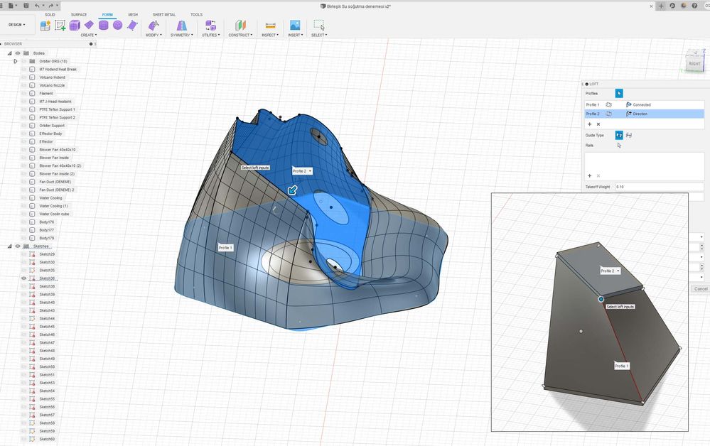

When using irregular geometry loft, White correction points used to correct the geometry do not appear. (Sellect loft input) This is sometimes output and sometimes not. I can correct when these points are white, but cannot correct when they are black. What is the reason it is black?
I wonder if it's a software problem. While you can do the same drawing in another document, unfortunately, these white correction points do not appear in a different document.
I'm sorry if I made a sentence mistake, my English is not very good

It looks like you are using Loft in the Form workspace.  This version of loft is different from the one in the Solid or Surface workspace.  That may be part of it.  But, also, those "point mapping" points don't always appear, if there is a clear mapping from points on one profile to the next.  If you share your design, we can look at it directly,

Thank you for your help, I also tried solid mode and surface mode. Unfortunately, I could not be successful. (However, I had never had a problem with a study very similar to this before (Almost one to one))
I think I am sharing the work link like this (I'm more new, sorry if I made a mistake)

thanks for the design link, @Seki_06 .  Here is what I found with this design.  There is a screencast, but it did not record my audio, so I did another video with audio (attached as an MP4).  Hope this answers some of your questions.
