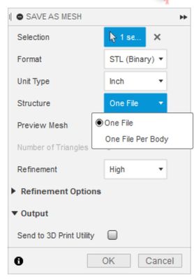

Hi @adammarkwalker, The problem is with the STL file type, once saved a single mesh is created regardless of components. Yet, within Fusion 360 you can select "Structure" and Save "One File Per Body" this is the fastest way to save out multiple STL files. To get this dialog I right clicked on the top of my feature tree and selected save as mesh.

Thats a perfect solution. Thankyou
