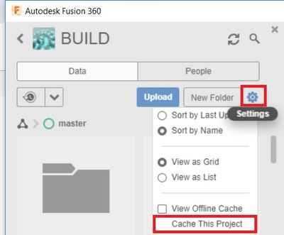

2. In the Data Panel, individually cache every project you wish to work with offline, as shown in the image below:
Add a Fusion 360 Project to offline cacheAdd a Fusion 360 Project to offline cache
