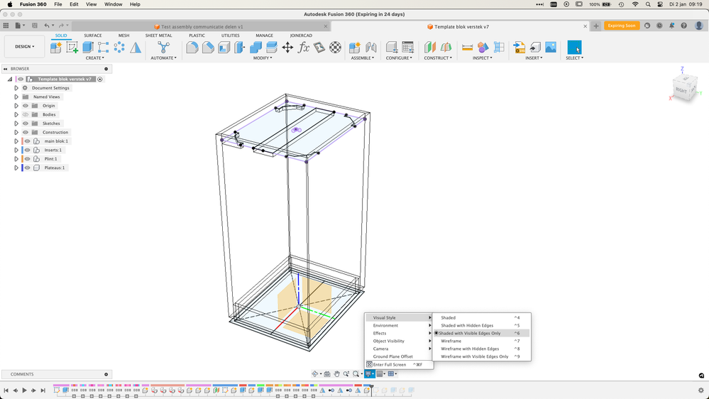

I really don't know how this is possible but I believe since the last update Im having issues with the visual style again. It changes to wireframe without doing anything, but the weird thing is.... it changes only some components in the model?! Then I am also not able to change it back again.... Sucky. Anybody can shine any light on this?! BUG is seems...

Is there anyone who can help?! It keeps on happening across different models and is driving me mad....Scherm­afbeelding 2023-12-27 om 14.28.11.pngScherm­afbeelding 2024-01-02 om 09.19.03.pngScherm­afbeelding 2023-12-04 om 14.50.50.pngScherm­afbeelding 2023-12-29 om 12.31.03.png

Hi Jeff, colour cycling is not the problem.. Id you look closely you see that there is a combination of view styles WITHIN one model! So one component is in wireframe, the other in shaded with hidden edges... I would be nice if that is an actual feature, but it's not and happens randomly...
@jeff_strater Seems like there are a few people using macs (on apple silicon) having this problem. See this thread as well.

yes, @HughesTooling and @infoM8PWE - I do think that this is related to the Component Colors setting, as indicated in that other thread.  @infoM8PWE - have you tried shutting off the component colors?  I have not heard any instances of this occurring outside of this mode.
