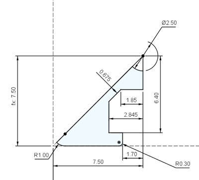

Used autoconstrain to fully constrain a sketch.
Try to reduce the width dimension (e.g. 150 -> 100) yields "Error: Failed to solve. Please delete or modify one of the following constraints/dimensions d39 : 100 mm"
File attached.

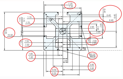

This sketch was created via too much work.
Get lazy.
Sketch 1/4 of the geometry and use Circular Feature Pattern instead of overly complex sketch.
Look how many duplicated dimensions there are that are not even functions.
I even saw the centers of Fillets dimensioned.
No logical plan here.
Edit: Actually, this could be simplified to 1/8.
Keep sketches simple.

rich
Funny. I used autoconstrain.
TheCADWhisperer
@rich
Why, oh why would anyone do that?
