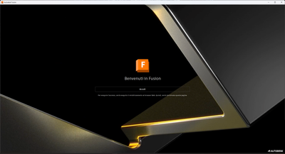

Last month Fusion was working, today I can't even login.
Yesterday, trying to start Fusion I was presented with a black screen with the login button,
Pressing the button brings up the entry that warns me that a window should open in my web browser, but this does not happen.
I have already searched the net and cannot find a solution.
From the Service Utility menu I have already done the repair, restore, uninstall and test but I have never seen any improvement and/or anything else.

@m_mazziniS6WKY thank you for the logs.
In your registry off you go to:
HKEY_LOCAL_MACHINE\SOFTWARE\Microsoft\Windows NT\CurrentVersion\Image File Execution Options
Do you see an ADSKidentitymanager folder or value? If so can you delete that and try Fusion again?

I tried all the possible ways and none of them worked, you really saved me!
