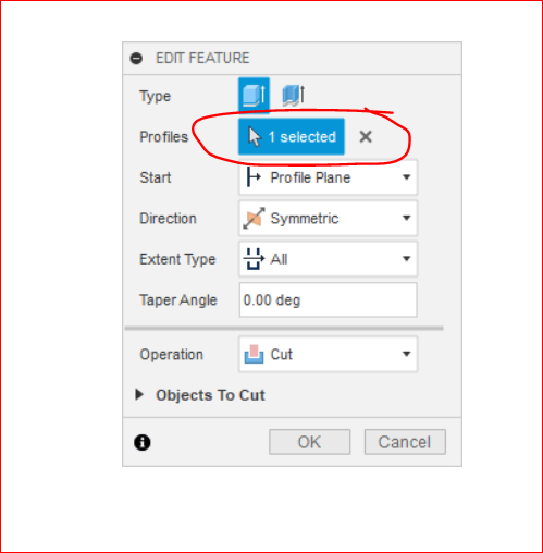

Select the correct Extrude icon on the timeline, right click for the Menu, and in the Menu is Edit Feature, select that.
Make sure the Profiles selected is highlighted blue,
then select more "Circles" from the sketch, and the count in the dialogue will increase as you do so,
other detail in the dialogue can be changed if required, at the same time.
