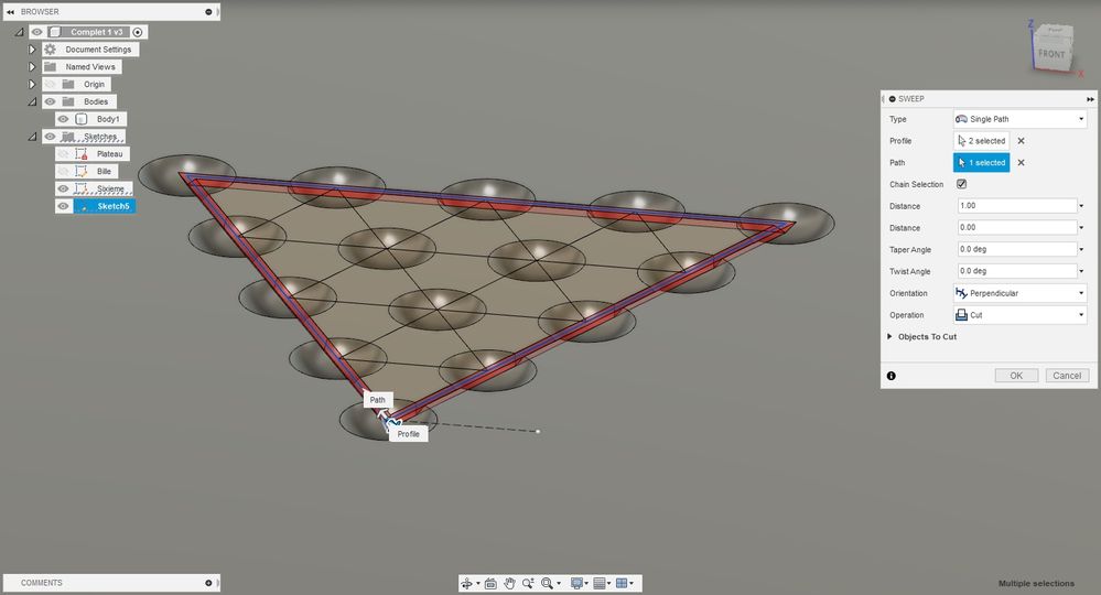

I would like to sweep my little triangle (v-carve) alone all the lines of my little triangle to join each holes. I am able to create the round path but I am not able to select
But when I try to select more line I have the following message:
How could I create this carve everywhere?

The path will not sweep with multiple intersections.  You will have to create profiles on every inside line and sweep them separately.  You should be able to copy and paste the sketch profile onto new planes along the paths.
laughingcreek
see attached.  this builds on the way @etfrench was doing it in the previous thread.  I used the pipe command to do the cut, instead of a sweeped cut.  but it's only done 3 times, so adding a profile on a "plane along path" and sweeping 3x times shouldn't be to bad.
