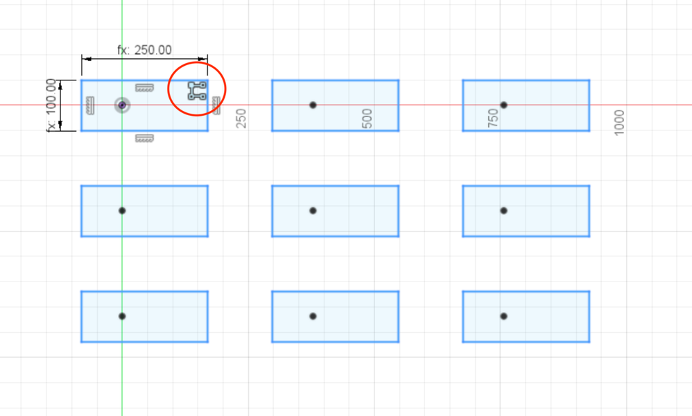

Hi! When I edit an old sketch, which includes a rectangular pattern drawing in it, I cannot find a way to edit and change the pattern parameters. I have to delete the sketch and start all over again. Is there a way to change pattern parameters within the sketch you open to edit? Thank you!

there should be a glyph in the sketch that represents the pattern:
select that glyph, right click and choose "Edit Rectangular Pattern":
that will let you edit the pattern

Hi
Thank you for posting. Please go to the Edit sketch mode and find this icon (pointed in the image below). Hover your mouse pointer over that icon and right click and select Edit Rectangular Pattern.
