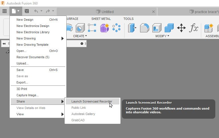

I did a Screencast of the importing of an Inventor 2021 IPT into Fusion 360.  I also tried to give you an idea that it is not a parametric component but a Direct Model object.  You can recognize features but apart from holes, it is not a lot of help.  You can also import Inventor Assemblies but it DOES NOT select all the components automatically, you have to select them manually and if you are not a "neat" Inventor user, that can be sometimes problematic.  You can always use an Inventor Pack and Go and get it all together first.  Here is want the Import screen looks like for the Inventor assembly containing the part I used in the video.  Look below the first graphic to see where the Screencast Recorder is located in Fusion 360 (if you installed it correctly that is).  I can send you a link to a video on how to create a Screencast and attach it if you would like.  It is too long for a Screencast so I had to do it in Camtasia.
