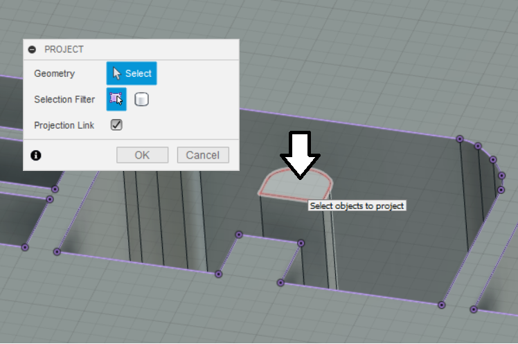

TheCADWhisperer
@Schwarttzy
See >>this video<< for trick to get any desired geometry to dxf.
In the video I missed getting the island faces - but I think you can figure it out now.
The key was to Project any desired geometry into flat pattern sketch and then right click > Save As dxf.
