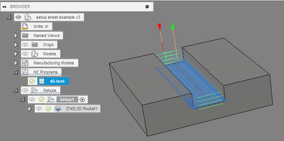

When creating a Setup Sheet from an NC file all the tool paths are now shown in the display of the model.  This happens for new files and old files that previously did not show the tool paths.  Did a Clean Uninstall and ReInstall and no change.  Have I inadvertently change some setting?
Setup Sheet created today shows the tool paths.
Same file - Setup Sheet created in April (is a scan from PDF) No tool paths - just the model

Before you create your Setup Sheet, turn off the visibility of the toolpaths in your Browser.  The second and third screen capture taken for two different Setup Sheets.
Toolpaths VisibleToolpaths VisibleToolpaths Not VisibleToolpaths Not Visible

My workflow is a bit different - I use the NC program to create the Setup Sheet.  When I select the NC program (45-test) the tool paths are visible  whether or not they are visible in the Setups.
completing the Setup Sheet gives the following image (tool paths are shown)
Seems to be something with using the NC program to create the Setup Sheet but I cannot figure out what I am doing wrong.
Figured it out - need to unselect "Show tool paths in NC Program" in Manufacturing Preferences
