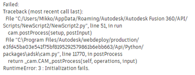

It was working fine for whole setups, but current version only accepts single operations as a parameter. We need to be able to postprocess full setups.
What happened?
I can post every operation to separate files, but If I try to post all of them at once it errors out.
This is the error if I try to post full setup.

So, cam.postProcess(operation, postInput) works but cam.postProcess(setup, postInput) does not work. It worked fine in previous version of fusion.

I have confirmed that the issue comes up only when tool numbers overlap. Our machine does not care about tool numbering when boring holes, so we have all of our drills with the default number 32.
when posting by hand we are greeted with a confirmation dialog. When using the CAM API, no such dialog is presented and things just crash.
