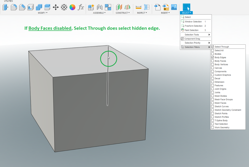

"Select through" disabled but still highlighting hidden edges on body
zalexzperez
zalexzperez
Unless I'm not understanding well the purpose of "Select through", I'd say there's something broken in the way the selection is currently working.
I just want to be able to select visible faces and edges. Why are all those hidden aluminum profile edges interfering while hovering the mouse cursor?
I tried replicating the problem with a simple box, and now the hidden edges are not interfering, but I kind of have the opposite problem. I can't highlight a hidden edge if "Body face" is also enabled. Take a look at the next two screenshots:
