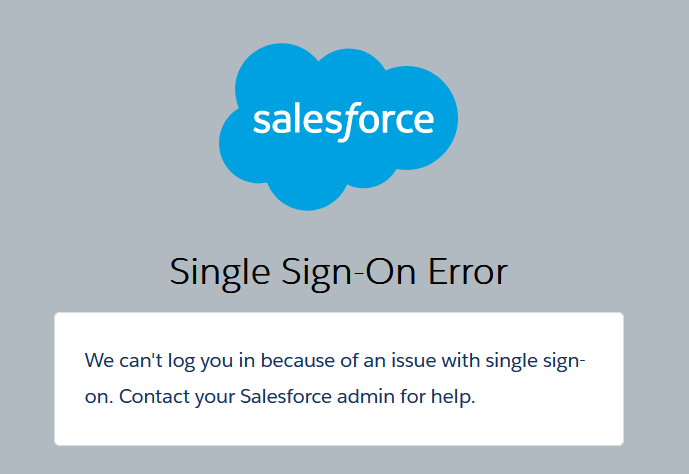

My internet connection is fine. The health dashboard says Fusion is operational. As more unproductive time ticks by, I try to open a support ticket on the website but I'm greeted the following:
