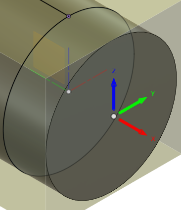

Please, when you have time, I have two contoured pieces. One works, with your solution, another no. The postprocessor does not output anything. I know it works because I've done this piece in the past. Thanks a lot!
Arun.rs
HI @toneanu_livia26
You have incorrectly set the WCS.
Set the WCS as shown in image and check the output
