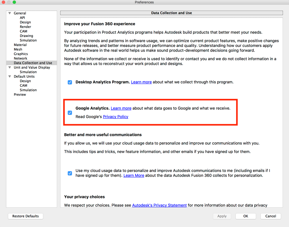

In your logs, I noticed quite a few errors when Fusion 360 sent reports to Google Analytics. Disabling Google Analytics in your Preferences (as shown below) may help improve performance.
I'd also be curious if limiting effects for performance helps out.

s.david.baxter
Paul, been working in the model now for about 15 minutes in on line mode
and performance is much improved. There is no purpose in tracking the
response time by command now because the response is almost instant. I
would like to keep the ticket open for another 24 hours if that is OK. I
will be back to you one way or the other before then. I will also disable
Google Analytics.
Thanks for your help and I will send very large Kudos when I Accept the
solution. You have been a great help.
