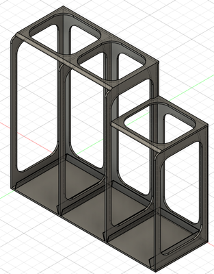

I created this sketch and used it as a basis of creating the model below.  In practice I learned that the sizes of the objects needed to put in the boxes is irregular and I need to change the length of the base by 1mm, which I thought would be simple.  However, I can't figure out how to move either side without the geometry deforming in unexpected ways.
2 questions - how can I make this base 1 mm wider and how can I understand what constraints are actually applied and how they work?

Only constraints showing are parallel, meaning pairs of lines will remain parallel, during any edits.
Add 1mm to the existing measurement of the article.  Set the new value in a dimension, when editing the sketch.

I can add a dimension to the bottom that seems to work, but it doesn't increase the width at the top.  If I try to add a dimension to the top, it says it's overconstrained.

It's Sketch2 and trying to make the base 2 mm wider and not understanding why I get weirdly constrained behaviors or errors around losing the projection plane.

Sketch 2 appears to be imported.  Hence here are no constraints nor dimensions, before you start adding them.
At the time you imported the sketch a face was existing to put it on.  That face no longer exists, and there is no construction plane to put it on, either.  Deleting anyway, when given the warning creates yellow icons, and sometimes red ones.  Use Undo to fix that, before saving.
You don't save time importing the sketch, takes this many constraints and dimensions to fully define it.
If it were me, this sketch only needs 2 lines, but that is advanced stuff, at your stage.
When you use Move in the Timeline, you are going backwards.
Blue, white and orange articles in sketches are not fully defined, and you have one fully defined sketch in this file (wasn't imported) and one empty one.
Change any dimension in this sketch and it will behave in a normal manner.

Thanks for the information!  It's odd that it appears imported because I actually drew it.  I didn't do anything fancy because I don't know how 😄
