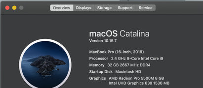

So I did search this before hand, and none of them seemed to be exactly what I am describing here. After one of the recent fusion updates. I think it was one of the 2 most recent this behavior started happening. It works initially upon opening and over time the behavior worsens to screenshots below. If I save everything and restart its fine again for a while. But then it returns. Its super annoying...

When I have my monitor connected to my macbook pro 2020 16". Specs below. Screen Shot 2021-06-04 at 2.12.50 PM.png
It does this thing where half of the menus when you click are off on the other screen, or they open way to the right of where they should be...
Monitor is a Dell U2720Q 27" 4K
Any ideas?
And... Yes the the monitor is configured to be the main display when attached to the macbook. All the settings are configured to be inline with the monitor. 60hrz refresh rate etc... I have used it without issue with fusion for over a year. Just one of the recent updates messed it all up!

Does not matter if it is open and I connect or if its closed I connect and then open the software. As long as I have both my macbook screen and the monitor hooked up together, it wants to put all the menus over on the macbook screen and not the monitor itself. I did discover however if I just use the external monitor screen and turn off the macbook screen, that seems to fix the issue. But sort of defeats the purpose of having multiple screens.
