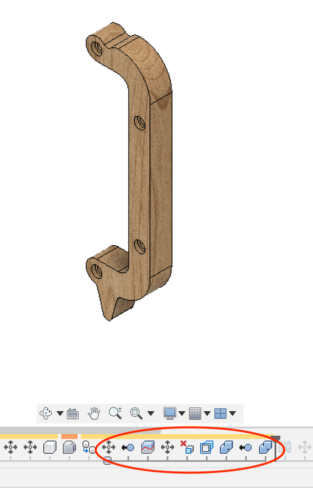

thanks, @jakubHX639, glad you got it working again.  We've done some investigation into the file, and have some theories about what the problem is.  It seems to be related to the way that Fusion stores some design information.  Specifically, when faces are "merged".  So, if two co-planar faces are joined, usually with a Combine feature, all of that internal information from both faces are combined.  And, in the case of some of the bodies in this design, that set of information is very, very large.  To the point where trying to process it hangs Fusion.  This is clearly a problem with Fusion that we will look into fixing.  However, there are ways that you can change your design methods a bit to avoid this problem until we are able to fix this.  We noticed when we looked at your timeline that there are a few cases where there is a sequence of features that result in this kind of face merging.  This sequence, for instance (I added the timeline group just for my own use):
Just before the final Combine in that sequence, you can see that 4 bodies exist that share a lot of faces in common:
and in one case, there is a lot of common faces between two bodies:
These shapes are pretty simple, I'd recommend considering using an outline sketch + Extrude, if that's possible.  I understand that it's a workaround, but it might help avoid this problem in the future.
