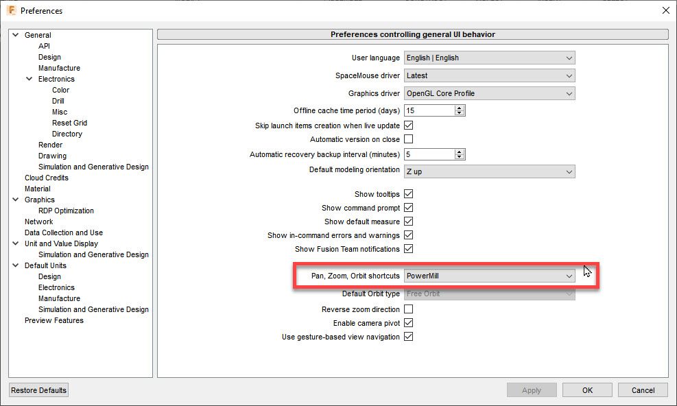

You mention that you want to Hold the Shift key + "Mouse Wheel".  You do not mention what you want to do with the mouse wheel.  If you set your Fusion 360 Preferences for Pan, Zoom and Orbit Shortcuts to "PowerMill", you can hold the Shift key, press and hold the mouse wheel and drag to pan in any direction.

I would really like to be able to set custom combinations for panning. I said scrolling, but I actually meant panning. Ideally I'd like to keep the scroll wheel as zoom, and then pan on either axis using control and shift as the modifiers.
jhackney1972
Then the Preference setting I showed you will do as you like.  Zoom by rolling the wheel and then hold Shift and hold the middle button and drag.
