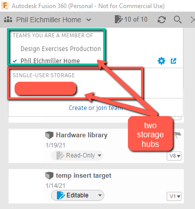

Have you looked at the team hub switcher? It sounds like you are in a team that you don't own.
What is on your hub list?What is on your hub list?
