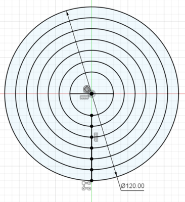

Hello, I got the same issue with my model.
Using the thicken feature seems to cause a memory leak. On my computer it increases from let say 700 Mb to 11 000 Mb RAM usage and it won't eventually stops.
Precision: my model is pretty easy, just some flat surfaces to thicken.

that design is not "simple".  Yes, the geometry of each face is simple, but there are dozens, maybe hundreds of faces here which have to be thickened, and the intersections between each face have to be trimmed off against every other face.  This is a very complex operation.  Yes, it will take a lot of memory, and a lot of time to complete this operation.  My guess is that Fusion is not crashing, but if you left it for a long time, it will eventually complete.  I don't know what the inputs to this were, but my guess is that there are ways to achieve this that will be more efficient - perhaps creating each surface separately, thickening it as you go might work.

A step by step approach seems sensible. Don't just thicken everything at the same time 😉

Thanks for your replies. I tried to thicken just a part of the model (selecting between 2 and 16 faces instead of the whole 37 faces) many times and it worked without problem. After 7 thicken operations the entire job was done.
But still, I don't understand why it's been such a problem. I mean, if the whole model has a high complexity in regard to this feature, why splitting it in 7 pieces solves the issue? I was expecting that, as long as I walk through the whole model, each thicken operation would take more and more time, to a point that it's becomes pointless to continue.
Moreover, I tried to reduce the model complexity to one ring and like 7 edges (so 7 intersections). Doing so, and trying to thicken the whole model on the same operation leads also to a crash. But deleting like 4 more edges (reducing to 3 intersections) makes it able to do the operation properly.
Seems weird to me.
Message 8 of 18
TrippyLighting
The first thing I'd like to note is that your sketch is not fully defined, which should not be the case for such a simple thing. I'd also not pattern or use symmetry in the sketch and pattern the surfaces instead of sketch objects.
The second thing I noticed is that the outer ring surface is present twice. There are 8 ring surfaces but only 7 rings in the sketch.
If you thicken all the rings first and then thicken the "slices" second then this works just fine.

Indeed, but I can't understand where this double outer ring come from. In the sketch there's only one circle drawn. But Fusion 360 crashes even if I delete it.
