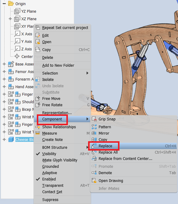

TheCADWhisperer
@Anonymous wrote:
ps. Can you replace any components by e newer similar version in assy - as in Inventor for example ?
I could be wrong, but I don't think you are going to find the equivalent functionality in Fusion.
Attach your dummy set of files for experimentation in Fusion.
Message 5 of 17
Unfortunately I was talking with Autodesk local support - exactly in Fusion we can not replace components as in other CAD as Inventor. Only manually put the second component and make constraints to older one, after that we have to delete older component. Unfortunately a new component have not any constraints as the older one.
