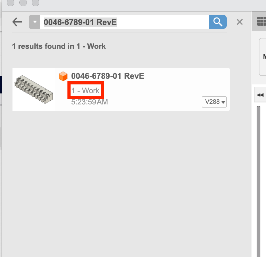

FrodoLoggins
Similar to this issue I had last week @john.koerner.
Now I have files missing from "my recent data" and my "1-Work" folder.
I definitely have more than 1 folder and 1 file in my "1-work" folder. I can even do a search for the file I'm looking for:
I DEFINITELY did not put it in the folder "A OLD"  inside my "1-work" project but that's where it is apparently. ALSO Fusion's saying I last worked on the file yesterday at 1:11 but.... also... this morning at 5:23AM. Both of those things can't be true and I was definitely asleep at 5:23AM:

john.koerner
For the recent list, we need to do more digging in the logs to see what is going on.
For the file that you searched for; the search results show the project that contains the file, not the path to the file.  So the result showing the 1-Work result is showing that name because that is the project name, even though it is in the "A Old" folder.  I can't say how that file got into that folder, but since the web and the data panel are both showing that file in that location, that is where it is currently stored.
The last saved and last updated times is a known issue that we are tracking in our backlog. It is only a display issue, the data is right in our backend.
