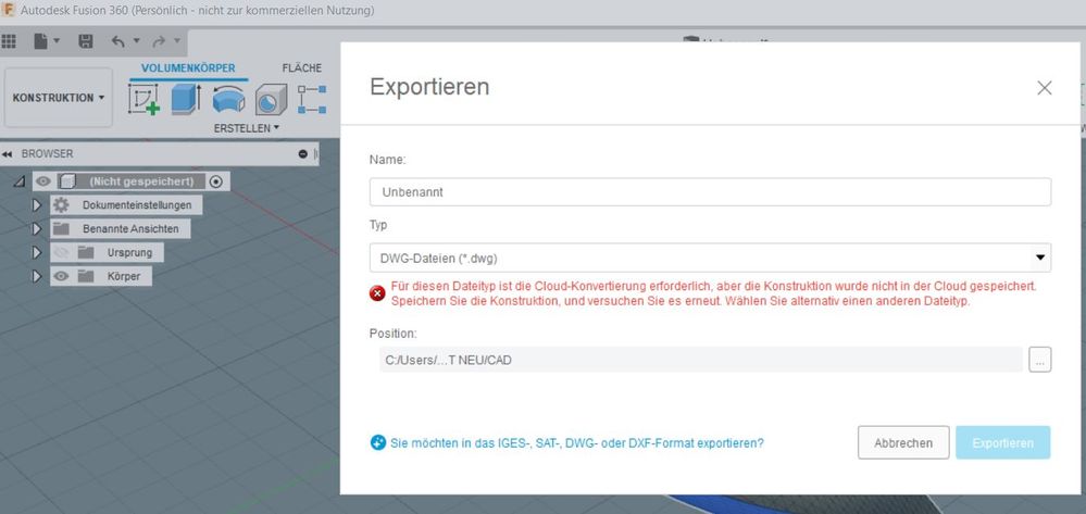

Dear Seth Madore, i registered yesterday for non comercial use ...
2020-11-11 12_11_10-Fusion360 Export skp.jpg2020-11-11 12_12_27-Exportieren-stl.jpg2020-11-11 12_13_18-Exportieren-obj.jpg2020-11-11 12_13_45-Exportieren-fbx.jpg2020-11-11 12_14_08-Exportieren-dxf.jpg2020-11-11 12_14_37-Exportieren-dwg.jpg2020-11-11 12_15_21-Exportieren-ipt.jpgIMG_4463.jpg

g-andresen
try this (as requested in the screenshot)
1. save your  design in the cloud
2. export it
The export of some types requires translation, which is done in the cloud.
The export of designs that are only stored locally or not at all is not possible.
