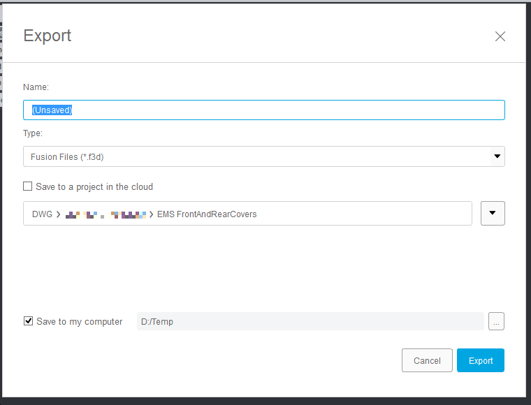

There are 2 ways to export, one from the file menu and one by right click on a component in the browser. Both of these options let me save to a folder on my computer, one exception is if the design has other designs inserted into it. If you are working with derived designs there's no way to work with them without the cloud.
Here's the dialog I get if I right click a component in the browser, no problem saving to my drive

I get the export window but pressing the export button doesn't do anything
jhackney1972
in reply to: deanmarcott
Did you look in the drive location you told it to save to?
You would be a lot better off using the Save to Mesh tool.
