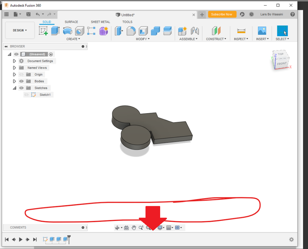

When I start Fusion 365 the history marker is not visible.

Hi @Anonymous,
A few things, this thread is about the marker being missing not the design timeline itself and yours is definitely still there:
