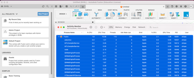

I'm having a very similar issue on the latest versions of Fusion, running on macOS Sonoma 14.5, on a whole lab of Mac Studios that we have.  The workaround I have found is that if you force it to run in Intel mode via Rosetta, it seems to be able to load everything properly. But that's not ideal as it makes the app run slower.
What's also concerning/curious about it is that this issue only occurs with the Admin/Lab Installer that we've pushed out to our Macs using out MDM (Jamf).
If I, as a user without Admin rights on my Mac, run the regular streaming installer, the Data Panel loads fine.
You can see the difference in the processes that are running. In the admin installed version, there are no QtWebEngineProcess running at all, and thus (it seems) that the Data Panel does not load.
In the other screenshot, the one from the regular user installer, you can see that the Data Panel works and there are a bunch of QtWebEngineProcess listed.
This is a REALLY big issue for us, and since we have the Educational License, we have not yet been able to get any support for this issue.  I'm hoping that maybe someone at Autodesk will see this message and respond ASAP. There have to be more people experiencing this issue!
Admin installed version running:
User-installed version:
