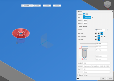

Recently I noticed that when I use the 'Hole' command to generate countersunk holes, the cone-shaped cutout for the countersunk screws is too large.

If I generate an M4 hole in F360, this is what I get:
... depending on the chosen standard the diameter is 10 mm or 9.4 mm ... This is way too big. What am I doing wrong?

We might be using the maximum values for countersink allowance. I agree its rather large compared to what i'd expect and i'll log this with the team. In the meantime you'll need to manually pick the diameter of the countersink you'd like.

According to the engineers bible, the ISO Standard for the top diameter for a countersunk hole for a M4 screw is 9.18 mm.

Thank you for your response. How do I manually change the diameter? The corresponding values are 'greyed out' meaning I can't edit them...
I also find it a bit annoying that every time I change a setting in the 'hole' dialog, the 'Size' jumps to a (seemingly) arbitrary value, instead of staying at M4 where I put it.

Change the hole tap type to 'simple'. Then you can manually specify the countersink diameter.
