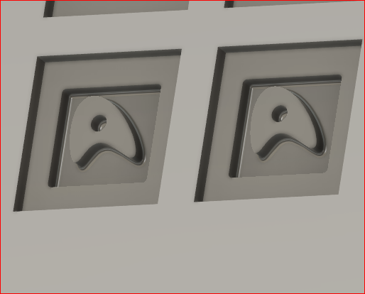

Hello
Thanks a lot for your help. It's been a while but I didn't have time to do it before.
I tried another way and looks ok, does it? 😉
Any advices before production?

davebYYPCU
I'll need the file,
Looks like you stuck to some Shell commands, yellow sketches should be fixed. and Move command is a red flag to most of us, that something is being fixed with it.
Might help....

Hello
I was able to do as you told me, Thanks a lot. Great help.
Still a small issue remains, it might come from the logo design itself. Some areas don't allow to perform the fillet tool.
Unfortunately I am not supposed to send that logo to anyone.
If you have any advices let me know. And if really not possible to see what is wrong without the file I'll find a way to send it.
I did two version of it as we are still thinking on which one will suit us the best.
Thanks again for your precious help
Message 11 of 13
davebYYPCU
Looks like you got most of the fillets,
they can misbehave if there is a super tight corner where the fillet will try to overlap itself.
you have to either open out that area, or make it into a sharp corner.
Might help....
