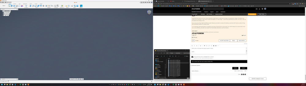

So around the same time that MS Excel changed the default font to Aptos Narrow, I noticed that Fusion 360 had a new font as well and for whatever reason on my screen it's Almost unreadable.
High-DPI Application Scaling is on
High-resolution canvas graphics on high DPI displays is also on
Is there some way to change this back to what it was before?

Hi @hoss, the font on Windows should still be Arial in those areas. Does the issue persist if you reinstall Fusion, or uninstall Office? Could you please also confirm what region and localization Windows is set to?
The UI framework that Fusion is built on has some automatic font fallback behavior if the current system font cannot be used to display the glyphs in question. Normally this happens when naming documents and objects within Fusion in an unsupported alphabet, but this behavior affecting English is new to me. Is there anything else that might stand out about your Windows configuration? Roughly how long ago did this start happening?

Thanks for your reply. I just un(re)installed Fusion 360 and same issue.
I then Uninstalled Fusion, then uninstalled Office Office and reinstalled Fusion, rebooted. Same issue.
I'm on windows 11, in Canada but as most Canadians my language is set to US
These are all the Arials I have installed:
After a little googling this is a list from Powershell:

My system setup should be more or less standard.
Hard to tell exactly when the happened but I first noticed it in the font change in Office in Early  February so I would have noticed it in Fusion sometime after.

Not yet, @hoss. Thanks for your patience. It's proving difficult to reproduce internally, but is still under investigation.

There are a few registry entries that might be worth exploring - you already did the one in \Fonts\, but you could you also check the following?
Computer\HKEY_LOCAL_MACHINE\SOFTWARE\Microsoft\Windows NT\CurrentVersion\FontSubstitutes
Computer\HKEY_LOCAL_MACHINE\SOFTWARE\Microsoft\Windows NT\CurrentVersion\FontMapper
Computer\HKEY_LOCAL_MACHINE\SOFTWARE\Microsoft\Windows NT\CurrentVersion\FontMapper\FamilyDefaults
Computer\HKEY_LOCAL_MACHINE\SOFTWARE\Microsoft\Windows NT\CurrentVersion\FontMapperFamilyFallback
Computer\HKEY_LOCAL_MACHINE\SOFTWARE\Microsoft\Windows NT\CurrentVersion\FontLink\SystemLink
On systems without Office, I don't believe Aptos is referenced anywhere in these registry entries, so if you see any references to Aptos, especially in the context of Arial font or (Default) font family substitution, that might be worth investigating further.

Here you go. I have since reinstalled Office since I needed it again but I'm not even sure what Font it is. there is no mention of Aptos in this listing and Photoshop and Whatthefont can't seem to tell what they are either.
The office thing might have just been a coincidence but it happened around within the same week I think.

hoss
Hmm not sure either, maybe the window was not maximized I just noticed that when I change window scales the application is not in maximize mode when I restart it, maybe that is what happened.
Here are a new full screen set of screenshots.
After each screenshot I quit Fusion, changed the window scale and restarted fusion and clicked on maximize (except for the one I missed).
I didn't have time to grab the other monitors today.
225% (this is actually the largest option I have)
200% (not Maximized)
200% (Maximized)
100%
