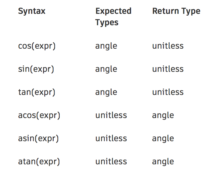

Phil.E
In your parameter, you are applying floor to a value that has units. That is not allowed, as per the chart above. Floor works with ul "unitless" values.
In order to use floor in an expression for a parameter that has units, you simply need to include a nested function that removes the mm units before using floor. See if this works for you:

@Anonymous
Actually, I said it's a bug in the posts above. "It should reject any use of units, which is the bug." This was logged a while ago as a bug. (internal reference FUS-21937) Another possible solution would be to allow use of units, but that is a much larger project for us. Sorry for any confusion about that.
If you look at the chart it shows one column as "Expected Type" (which means "this expects you to feed it unitless values") and one column as "Return Type"(which means "this returns unitless values to you"). Is there a label that you would expect to make that more clear? I'm glad to log a suggestion to the web team.
Thanks again for your feedback and help.
