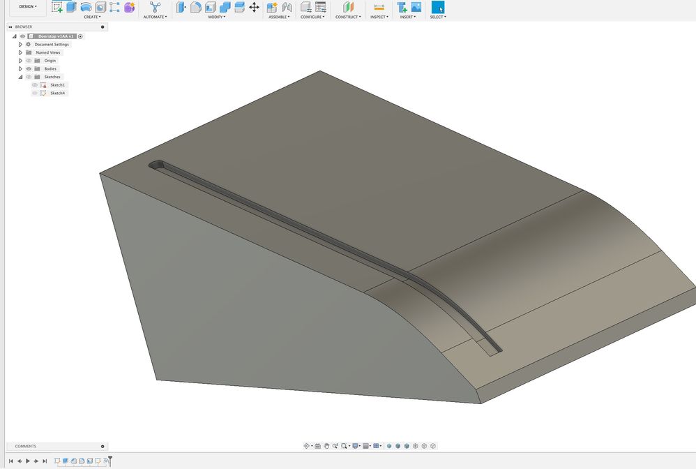

I'm trying to learn fusion 360 but i am stuck on one thing, the guy in the youtube clip are able to emboss but i just can't. I have tried to go back in timeline and find the problem, search for others emboss issues in the community.
I do not get it.... but i would be very thankfull if someone could tell me what i am doing wrong.
I attach a picture and the f3d file!
Thanks alot in advance.
Sincerly Martin

When selecting Faces to Emboss, take off the Tangent Chaining check box and use your Ctrl or Command key to select the three faces required.   Model is attached.

Thank you so mutch sir!!
