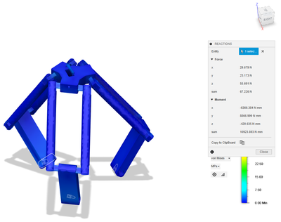

Can I get the reaction torque on a shaft that isnt on the x or y axis?
This is a delta robot with a 20lb force applied to the effector. Each crank is fixed on its revolute shaft location. I want to understand the torque requried to hold the structure static.
The reaction forces page when highlighting the revolute joint of the crank arm shows torques in 3 axis. The arm on the right happens to be aligned with the x axis so I can see the torque on this arm to hold the structure still is 534Nmm. The other crank arms are not aligned with x y or z. How can I see the torque requried to hold the delta still?
Image shows reaction on arm aligned with x axis.
This image shows reactions for the arm on the left. What am I to do with these numbers?
Thanks for any help!

Hi @cfischer_engr,
Reactions can only display values with respect to the global coordinate system, there isn't a way to show them via a local coordinate system.
A workaround is to run the simulation with the model rotated, so that the arm is aligned with a global x, y, z axis. You can do this in Simulation, without affecting the model in the Design workspace.
  1. Go to the Simplify workspace
  2. In the browser, right-click on the Simulation Model > Clone Simulation Model (with the study)
  3. In the cloned sim model, use the Modify > Move / Copy command to rotate the entire assembly so that an arm is aligned with a global axis
  4. Run the simulation for the rotated Sim model (make sure the force is still aligned properly)
Hope this helps!

Thank you for the response.
This is very unfortunate as rotating and resolving for each arm is a lot of work. Especially when I want to analyze many locations to understand the entire work envelope.
I hope fusion considers a more articulate method for displaying the reactions in the future.
